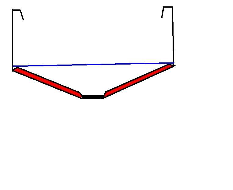

Just to clarify, I may not have described my concerns well. The cockpit floor is wooden I refer to the hull itself as per the below taken from another forum:
Here's where the balsa core is.It's laid INTO the hull of the boat-ie fibreglassed in and is part of the hull.It needs the test with the heel of your hand to tell if it's gone soft as you HAVE to be able to compare the feel of it with the feel of the rest of the hull in the cockpit area.
IF you've got the problem (there needs to have been a hole through the inner or outer skin at some point coupled with water getting in there) it will be obvious as there will be a very definite soggy feeling in the area where water has got in compared to the rest of the area.
This is USUALLY local to somewhere the inner skin of the cockpit has been damaged at some time.Drilling a hole and prodding one area through the cockpit floor isn't valid for that reason.
If you can't do the hand pressure test on the inside because of the inner floor, do it from the outside-but you'll need to use a fair bit more pressure with the heel of your hand as the bottom layup is thicker than the inner cockpit skin layup.The balsa core WILL be in your boat-it's the way the 501 was laid up.

What kind of boat is it? There must be some item attached to the hull you're concerned about. This can be removed. Looking at the hole it is installed in will tell you if there is a core or not. Not many hulls are cored but the majority of decks are. The previous post is not correct. The test with your hand has 2 faults. One is the core is not mushy until it rots and if just wet it can be very solid still. The core doesn't rot that quickly. and moisture alone will not always separate the core from the skin along the bond line. Two if the skin is thick enough that method will never work.
If there are no penetrations through the balsa core why worry about it. Balsa has been used in many hulls of all sizes and the only issues are where there are holes through it to mount thru hulls, transducers, or drive shafts. If this is not the case it should be fine as there is no way for water to get in without a break in the inner or outer shin. I wouldn't cut a hole in the bottom as you will then have to repair it properly. If the balsa core is wet the boat won't fall apart. It is there as a stiffener for the panels on the bottom that are very probably thick enough by themselves for strength. The balsa with a thin glass layer over it will stop the hull bottom from flexing. Here's a link I'm not sure you're aware of for the Microplus. http://www.microplus.dk/
Yes, highly unlikely the hull will be balsa cored. Microplus were cheap and relatively unsophisticated boats and the shape of the hull is sufficient to give the required stiffness with solid layup. You may find re-inforcement stringers in the flat panels aft and the cockpit floor may have balsa to stiffen the large flat panel. The transom may also be sandwich construction depending on the HP rating, but the sandwich filling is likely to be ply.
