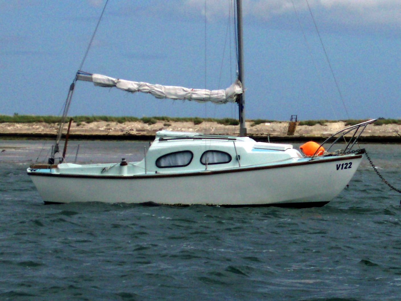

Just checking my maths...... :D
9' boom, 4:1 set up...
Hypotenuse of a 9' right angled triangle (ie. allowing the boom completely out) is 13' (it's 12.7' but I've rounded up)
So line length is 4 x 13' (which is approx. 16 mtrs in modern money - rounded up); add on some for the tail and I think 18 or 19 mtrs will do...
Good enough?

Yep I agree with the maths.
Don't buy rope thats too large for the blocks ... dont ask
Your 13ft is in the horizontal, and is one side of triangle back to cockpit sheeting point, say 5 ft below the boom? So out to boom end will be closer to 14ft x4 + 6ft tail and you need closer to 20m.
I don't really know what a Fantasie 19 is, but I suspect 5 feet between top of transom and end of boom is rather ambitious. I was allowing for that factor in all the rounding-up going on.
Pete
Good point, but not as much as 5ft on a Fantasie 19 although the mainsheet horse is a bit further aft of the end of the boom so maybe should start with 10 ft for one side of the triangle
My best estimate would be 19m minimum.... so yes buy 20m... one end will need an eyesplice and the other a stopper knot .. they all take a bit

Think the maths is fine, but personally would trust a tape measure more. Put the boom out as far as you can, measure distance to traveller, multiple by 4 then add some on for tail, splice, distance round blocks.
Also would suggest that you add a further couple of metres. You'll probably find that some points chafe/ show signs of wear. You can end for end if not too bad b,it there may be a point where you need to cut out one end as it's too far gone. If you have the extra couple of metres the main sheet is good then for several more years. If it was the perfect length already then you will need to replace the lot.

Sorry - this is for a Hurley 20, my Fantasie went to a good home last October... the point about drop between boom end and transom is well made - I reckon 3 feet or so and was hoping the rounding up would account for that.....
Rule of thumb for boom end sheeting and 4:1 is boom length x 6, for 6:1 it's boom length x 9. So, 54' or 16.5m.
It will be interesting to see how much line you have left if you buy 20m, to test the rule of thumb.
I would buy 50m of thin cheap string. Fit it, measure it, then copy it. A metre too little would be catastrophic. A metre too much would be unnecessary clutter.
