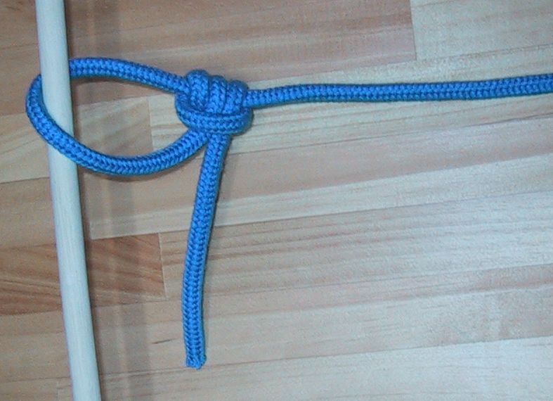

I use one which goes a bit like this: Looking at pics, it's a fisherman's bend, without the second half-hitch.
You put the end of the rope through the hole, twice.
Take the end around the halyard (the bit which goes up the mast) and tuck under both loops on the headboard.
Pull tight. This stays nice and tight and weve never lost the main halyard in 10 years.
HEre's a pic: http://www.sailingusa.info/images/fisherman_bend.jpg
Hope that makes sense!

A Fishermans Bend

BTW, I know the Fisherman's Bend - illustrated above - as an Anchor Bend.
Another vote for fisherman's/anchor bend. Use this on both my boats, no problems, and never had it jam. Although expect maybe on a dinghy I wonder under what circumstances you would need to untie the halyard from the sail in a hurry? Is being on the boom not low enough for you?
