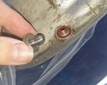

The boat is out of the water and we’ll do our annual switch of saildrive oil this weekend.
The drain plug rubber o ring needs to be replaced each and every change. The part number for this guy is 3855081.
I have an o ring set of various sizes and thicknesses. Does anyone use their own o rings or is this a magic, special o ring made by Volvo out of pixie wings or something? I seem to remember it was slightly thicker than standard o rings?

I had water in the oil which I found one cruise when in Le Havre. The useless volvo engineer in Cherbourg told me it was shaft oil seals. But a phone call to Volspec engineer in Tolesbury said it was the washer on the saildrive drain. They were right. The volvo dealer in Cherbourg could not source a seal, so I took a thick neoprene washer from the top end of the pump handle spindle of my Jabsco Heads & used that. It lasted several years & several oil changes. The suitable seal is just a typical rubber ring one will find in your box of rings
The Volvo one is a skiny little thing & I now have half a dozen.

I would always replace it every time, the question was more is the part by Volvo that is this rubber o ring any different to one from my o ring set? I will get my digital verniers out once the washer is out, but wanted to know if anyone else used a different washer to the Volvo part number of 3855081 - the postage itself will cost me lots more, and it might not arrived on time. Part cost = £2, postage = £20 for next day!

The O-ring material needs to be one that resists both oil and water. Some saildrive oils can be quite aggressive, in which case Viton would be best although nitrile should be OK. Neoprene is less resistant to oil than nitrile although it is sometimes used for oil seals. If your O-ring kit is for water applications such as water pumps it may well be that they are EPDM, which is very poor in any kind of oil.

With the exception of the 120SE I think all of the 120S's use regular 15w40 mineral oil so nitrile (nbr) should be fine for these. I suspect most of the problems stem from not using the right size o ring and/or not following the lubrication and tightening instructions in the workshop manual, which will cause the o ring to distort. On the 120SD, for example, the correct o ring appears to be the wrong size as its a loose fit on the plug but there's a slight recess on the bottom of the leg that it fits into.

Uses engine oil. Have usd alternative rubber ring washers of size to fit. If sealed then no oil will leak out so try before fully filling. never had a problem. I don't change it every oil change. If you still get water in oil after that it will be the shaft seals. Fairly easy DIY job. Have a go.
