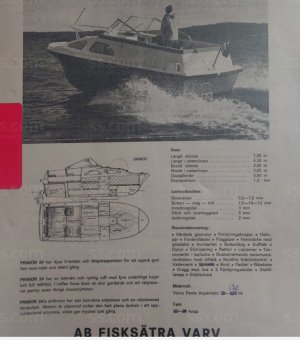

Attached is the original sales blurb for it ... with sketched line ..

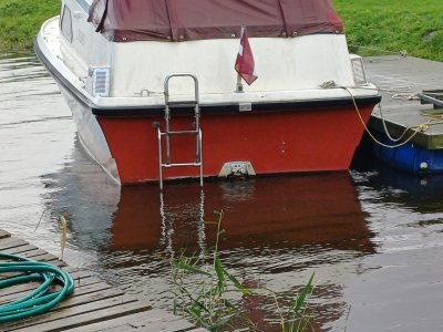

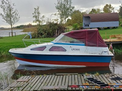

OK - just took a couple of photos to show that she really does sit down at stern even when no-one on board.
I may be wrong - but I believe that the drive should not so buried like that when at rest and no-one on board. That at least a reasonable part of the drive head should be above water ?

It does look a little low at the stern compared to the drawing in the sales brochure.
Presume there's no water in the bilge/the bilge is totally dry? Sometimes there is a false bottom/floor under the engine, and you can have water trapped under there and not know about it.
