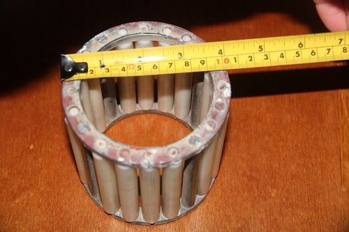

Can anyone suggest someone to fabricate a replacement for the pictured lower rudder needle bearing, taken off my Humphreys custom 36?
It runs on an 80 mm nominal diameter stock, in a 107 mm internal diameter rudder tube. I can give whoever does the work precise measurements.

You need access to a toolroom to fabricate this so look for any Toolmakers / Precision Engineers in IOW, (yellow pages) take it along to them and negotiate a price.

What is the problem? If it is just worn rollers, then any competent engineer should be able to replace them and the pins they run on, whilst retaining the existing cage, which is the hardest part to make. I very much doubt that the bearing is a one off, so a visit to a bearing supply house (look in Yellow Pages) may reveal an off the shelf replacement which is likely to be much cheaper than the fiddly job of replacing the rollers. If the problem is wear on the rudder stock or a damaged outer race, no replacement of the rollers will solve the problem.
You could replace it with a low friction plane bush, I guess the shaft is SS and it will run dry? Just need to know the carrier material and sizes.
The bearing is a one-off, originally made by NeedleSpar, who no longer do this sort of work. The problem is indeed worn rollers. I have contacted a toolmaker in Freshwater, so I'll see what they can do and for how much. If they can just replace the rollers that would be ideal.
