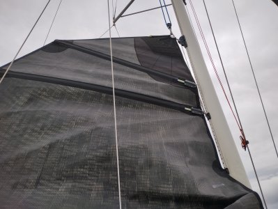

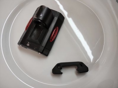

For an unknown reason a batten car end cap failed, and most of the balls fell out.
It's the car for the top batten at an angle.
What's the opinion on continuing using it like it is without the car until I get replacement balls (it will be best part of a week to South Uist). The main still seems to set ok without the car. A temporary alternative is move a car up from a lower batten.
Unfortunately all the intermediate cars are different. The only moving option I have is to move the bottom batten car & sail with a reef if that causes problems.
The wind is so light at the moment that it's all a bit of a theoretical problem anyway. Can't do much in a F1.

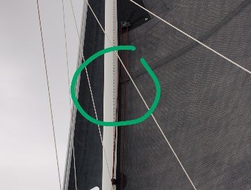

I can't see that there is masses of compression there. How does it look when hoisted you should be able to see if it is pushing in. Alternatively , take out the top batten and put up with a minor flappage
Interesting - I suppose you could slacken that top batten so there's NO compression - then tension might then keep the luff clear of the track. I reckon swapping the car with the bottom one and sailing with a reef is the better option - no risk at all of damaging the (expensive looking) sail.
I'm going to remove the batten tension then put a bit of milk bottle plastic around the luff held in place by the batten box bolts & see how it goes in light winds. If it looks like there's any rubbing I'll move a batten car, but it means taking them all off which is a kerfuffle.

I need a car end cap as well as the balls. They are on their way but the long weekend will delay their journey.
The mast track is external. Only a car fits, not a slug.

I have 100 spare balls, there are 50 in each of our cars. But Angus has blown his car to bits. It’s usually a lower one that hapoens to, if you let the main come down too fast. The upper cars all land on the lower ones.

Cars all jiggled around which with only a single offcut of track on board was a major kerfuffle as those who have recirculating ball cars will know. Now the bottom batten temporarily has no car.
There's a little bit of droop to leeward but not much. I've taken the metal elbow connector out so it's only bolt rope brushing lightly on a smooth part of the mast. The sail isn't rubbing on the track. Being just above head height I can keep an eye on it while sailing which I can't for the top batten.

Some car designs have rubber bumpers fitted between them to allow the sail to be dropped without damage. I used to crew on a Farr 56 for race weeks in the Caribbean and the skipper used to insist on dropping the main like a guillotine. Those little rubber bumpers worked really hard but no damage
