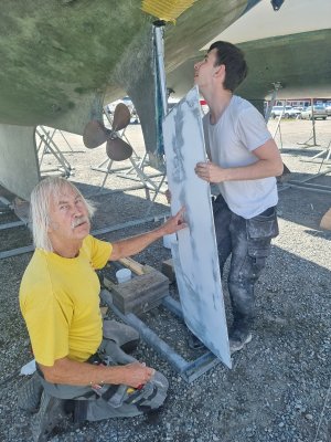

Ok, pleased to report that a bottle of whiskey or too in the right hands and we got the retired owner of the fibreglass repair yard to come in over the holidays and make us a new rudder (known locally as Plastic Jesus!). What a job! But it looks fantastic now and we are about ready to launch again. Insurance all approved. Next job is to claim the money back off the ferry company for not informing the chart makers of the aforementioned cable. Locals say loads of people have hit it. Why no one has complained about the lack of charted info I really don't know.

Leave your insurers to fight with the ferry company. That is what you pay them to do - pay your repairs and recover their cost from the third party if they can.
Looks a good job with the new rudder,
