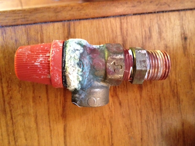

I've managed to get the PRV off and have taken a picture of it. This is it:
As you can see, it's covered in gunk where it has been building up over what would appear to be quite an extended period of time. I think it's been leaking water for some time, but I think it's much worse now. It says 3 bar on the end of the red cap. Is this normal? If I turn the cap anti-clockwise, it "pops" about every 1/4 turn.
If it were just a slight dribble, I wouldn't mind, but the water ingress into the bilges has been substantial enough to cause me concern. And with water being at a premium around here, I don't want to be losing water for no good reason.
I've popped into the nearby chandlery, but the chap has never seen anything like it, so no luck there.
Can I try and clean it up? Is it something that needs "popping" every so often to keep working right? Is this one beyond repair? ????
Ahh, I see it is like FC's PRV, only mine is 3 bar, instead of 2.5 bar.
Good to see, like many other things on this boat, that it was fitted incorrectly (with the hose tail pointing upwards). I'm going to try popping it a few times, cleaning it out and refitting it. Whilst I can't point the hose tail directly downwards, I should be able to have this pointing in a downwards angle, so hopefully that'll do the trick.

Any half decent plumber's merchant will have pressure relief valves in stock. Very common on boilers and hot water cylinders.
Crud gets stuck on the valve seat. Sometimes one gets lucky and it will wash out, but the usual is it gets stuck and the valve will dribble for ever more.

Success!
We happened to have hired a car yesterday to go sight seeing, so during our travels we also popped into a plumber's merchant. The chap looked at me with a blank expression when I asked for a "pressure release valve", but fortunately I had taken a picture. As soon as he saw it, he produced one that just happened to be sitting on the counter next to him!
I've fitted the new one and so far (touch wood) things seem to be looking good. I've not heard the pump run whilst the taps have been off (which it used to every hour or so for a second or two) and the pump also seems to run happier. No obvious leaks and no water coming out my newly fitted overflow pipe.
