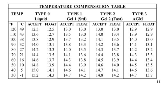

I have a Heart Freedom 20 inverter charger. Installed original in the 90s. Anyone with one will know it by the adage “oldie but a goodie”
I want to keep it as it is wired in very well and fuels all my 240v sockets and inverts 2kw.
Im currently using Trojan 6v paired to 12v and I want to switch to Victron lithium batteries.
I know I’ll need to get a DC charger to ensure the alternated doesn’t overload. But what about the charge profiles on the Heart? Will they work? Attached are the charge profiles.
What other considerations? My basically understanding is that lithium batteries like to be charged at half its capacity per hour. So 50amps for a 100ah battery. So I’d need to ensure the current output is manageable.

To answer your question about the existing charger, depending on temperatures, those charging profiles don't look ideal, especially is temps get down to the lower end, unless the charger has temperature compensation.

With regard the charging profiles of the Freedom, I can either manually select an ambient temperature or activate the automatic temp compensation. So presumably I’d turn that off and just select a profile which was best suited and on the safe side. So perhaps AGM at a temp of 16. This would fix the charge at 14.4 and float of 13.4.

I'd go for slightly lower voltages, the one at 14v and 13.1 would be OK.

If you use the voltages above and disable temperature compensation it should be OK Tim.
