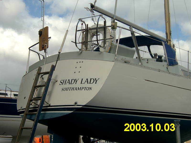

Nick come on you have a big Moody & the pushpit steelwork is easily capable of taking a liferaft.
Have a look at Shadys setup
& she was just a 30'
Personally I would only mount a liferaft on the pushpit as its EASY to get to & when you need to use it. you want a safe area to board from, maybe in a hurry. Your cockpit will be the easiest place!
