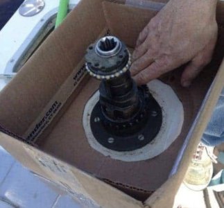

My yacht has Lewmar Wavegrip self-tailing winches throughout (the ones with four screws in the top cap). I am not sure when they were last serviced, so have just taken the drum off a couple of the winches to check their condition. My plan was to put them back together and service the lot in a week or two when I have more time.
The first winch (a Wavegrip 16ST) came apart and reassembled fine. However, when I tried one of the main winches winches in the cockpit (a Wavegrip 43ST), there was a problem.

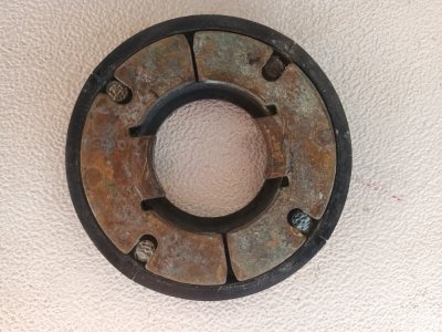

When I have tried to put the collets and top cap back on the winch, they don’t seem to fit. The collets are semi-circular with a tab which goes into a slot in the main spindle. The two collets have to be quite close together to get the top cap on over them and line up with the screw holes (see picture). However, the slots that they go into doesn’t seem deep enough and this means that there is a gap between the collets and the top cap won’t fit over them (other picture).
Is there something that I am missing here? Is there a technique for getting the collets and cap on? I have cleaned the dried-in grease on the collet and there doesn’t seem to be any debris in the slots in the main spindle. It seems like the tab on the collet is going in to the full depth of the slot, so I don't want to give them a tap with a hammer. I didn't take the winches apart - only took the drum off for inspection.
Thanks in advance.
I have the same winches and have had the same problem. The collets locate in two different parts of the winch, the bronze centre stem and a groove in the stainless steel main shaft. Yours is probably only located in the bronze centre stem. Just lift the main shaft a fraction of a mm by putting your finger down the star shaped hole and it should all go together again without any force.
Thanks. That worked perfectly. I think it might have been clear if I had disassembled the winch completely, but I only popped the drum off for a quick look.
