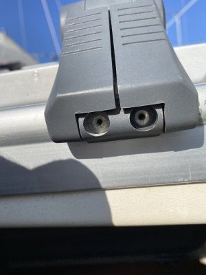

Anyone else has problems with leaks through an old style Lewmar hatch hinge? I think the pop rivets holding the lower hinge to the frame are leaking, but I’m loathe to drill out the pop rivets to replace them with some sealer added, in case it’s an impossibly fiddly job. The back of the pop rivets seem to be hidden in a recess behind the outer hinge fixing to the frame, so I’ll have to unscrew both hinges from the frame to get to them. If anyone else has done this successfully, I’d appreciated any advice about pitfalls and solutions. TIA.
