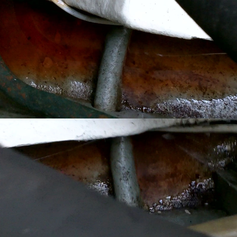

I was checking over my boat today. It has two fuel tanks that I filled up (so over 80 litres each side/tank) before crane out. On the port side I found what looks like a pinkish-coloured liquid. This doesn't seem to have escaped into the bilge or elsewhere. See below>
It seems likely to me that it’s diesel, and therefore I’m thinking that I might have a leaky tank. She'll be on the hard-standing until early April.

You should be able to determine if it is diesel just by sniffing.
If so, as the leak was discovered only after filling up, suspect a leak from the tank top, a fitting or a hose.
I had a slight and intermittent leak from my diesel tank the other year. Took it out in the winter and used a bicycle pump and some soapy water to trace the leak. Turned out to be one of the bolts holding the fuel gauge on the tank top – therefore only leaked when the tank was full.

BabaYaga: Good point. The leak maybe at the top, or in theory it could be that the diesel (if it is diesel) has found it's way down from an overfill when we filled the tanks up just before crane-out. Next time I'm over at the boat I'm going to obviously check to see if the spill is any bigger, and also try to spot what fittings are near the top of the tank. Thank you very much!
Captain Fantastic: To be honest I hadn't even considered repairing the tank myself, as I had assumed that would involve steelwork. I guess I could consider emptying the tank, and making a repair as you have ...but the problem is going to be getting the tank passed the engine, as I'm not convinced making a repair in situe is feasible. Food for thought though, and I'll certainly keep your experience and advice in mind when I'm making a decision. Thanks very much for your input!

I've been thinking about this overnight. Just a couple of points to add.
1) The last sail of the season was pretty rough in a force 8, so the boat and it's contents took a bit of a bashing ...and this means that the diesel would have been sloshing around vigorously.
2) The anti-freeze that I added during winterisation was pink.

You may be lucky then; the tanks tend to corrode at the bottom, therefore, if you had a leak in the tank, it would have been very obvious by now, with diesel everywhere.
However, if you have to repair the tank, i strongly suggest that you remove it first, as in situ repairs are most likely to be temporary.

Captain Fantastic: The liquid in the photos is maybe 3-4mm deep at it's deepest. I assume that it's gathered there over time since crane-out in October. Hopefully I'll be able to identify the liquid at the weekend whilst I'm cleaning it up. Then I'll wait to see what, if anything appears over the next few weeks.
