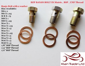

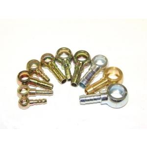

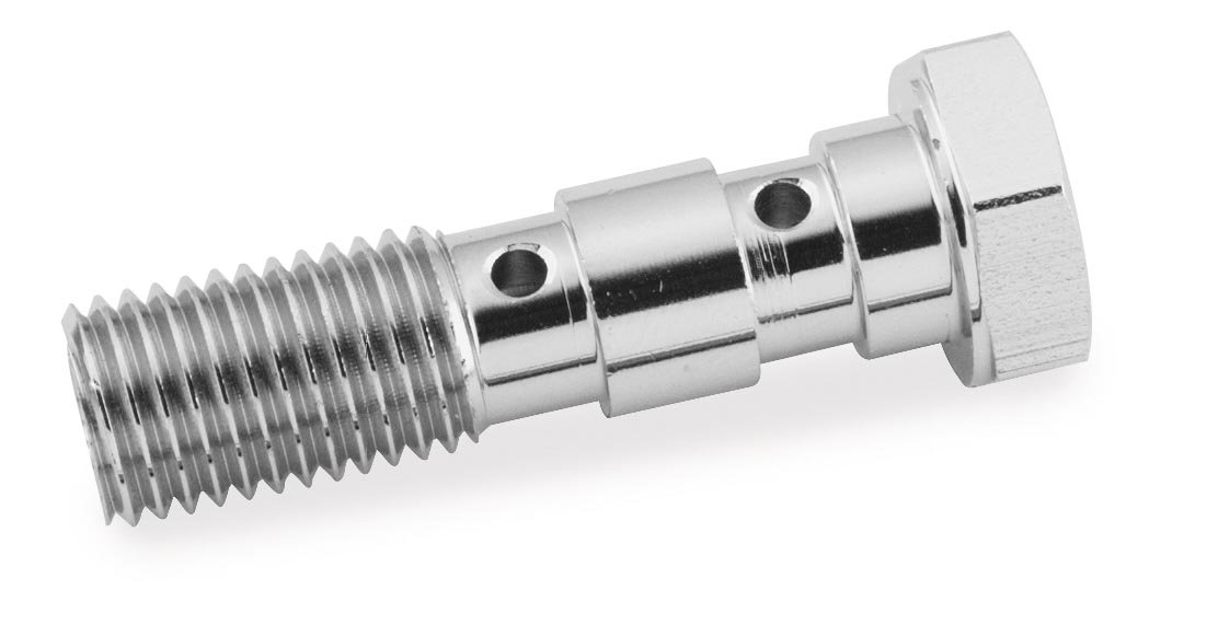

There are basically 2 types of double banjos
You can also get a 90 degree type as well
This is used with a single banjo bolt
2 copper washers are used
this is used with 2 single banjo connectors
This way will need 3 copper washers
