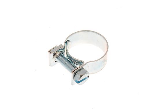

Jubillee clips are not great at small diameters. You are better with proper fuel pipe clips.

Thanks Lakesailor
I used standard worm screw type stainless Jubillee clips, I'll try again with fuel clips as per your photo.
