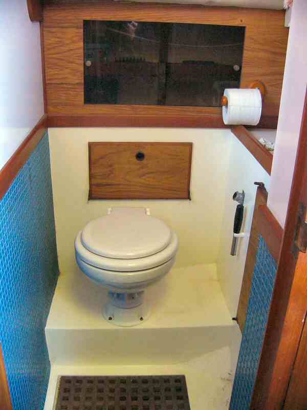

Installed a Lavac popular 8 or 9 years ago to replace a leaky RM(?). One point to note is that the Lavac seems taller than the one it replaced. SWMBO is almost dangling her legs when sitting. Apart from that it has performed faultlessly. We always pump about 25 strokes as we've got a very long outlet pipe. I also clean the pump every winter during layup, usually just a light coating of limescale to remove.
If the pipes can be routed satisfactorily, the Lavac lends itself to a very clean installation.
