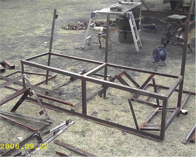

This is the type of platform I used when doing work along the whole length of the boat.
I do have a folding platform that I used for small sections but I moved towards the end one day and my foot went off the end while I was using and angle grinder and almost cut one of my finger off. I stopped using it with power tools after that.
Folding platform in the background upping a workbench.
I built up a platform with wheels on one end and a sack trolley on the other end. The legs fold for storage or transport to another site.
