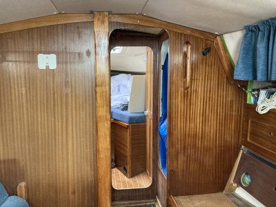

Westerly used a 30% sheen in the Morrells 450 acid catalyst high build up low odour lacquer. When I refurnished Concerto that is what I used and it looks good. The photo below shows how much sheen is on the refurbished side of the bulkhead. When mixing the lacquer I never mixed more than 60ml at a time as it sets quite quickly when applied by brush. I used 3 coats. I should point out before applying any lacquer, check all of the original finish has been removed by wiping the surface with a damp cloth. The wood should absorb a little moisture, if it does not resand the area otherwise you will get creamy coloured patches under the new lacquer.
