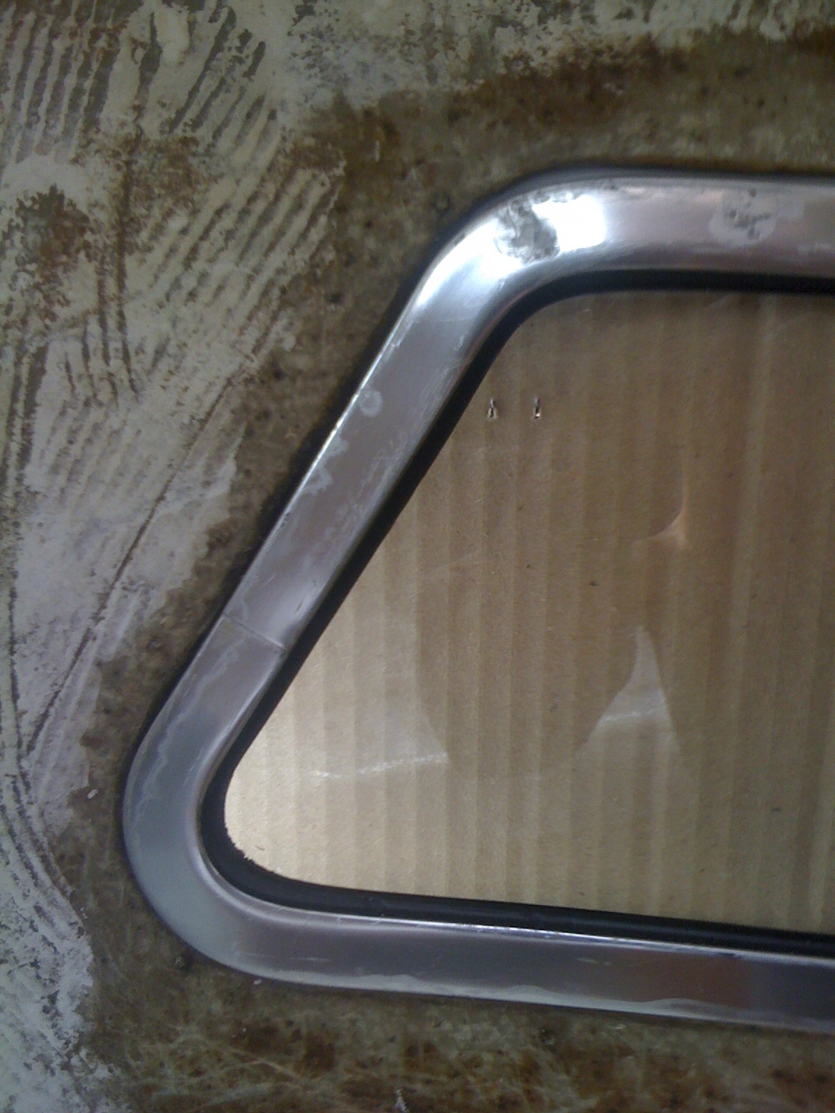

My aluminium framed windows had the glass wedged in with rubber seals and some powdery corrosion products. When I took the windows out the powder was all that was left and there was hole in the bottom of the frame. Water was entering the inside of the frame and running put the bottom through the hole. The end result was not only all the windows being refurbished professionally but most of the galley being replaced due to the subsequent fresh water damage to the wood over years. In my case it was not obvious just how bad the frames had corroded because they were hidden behind lining, so it may be worth investigating further just how bad the damage is.
This is the only photo that I can find and in this photo the holes at the top have been filled, but there were similar holes on the bottom.
