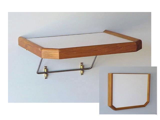

While sanding some more, a thought crossed my mind. What if I just strip off the knackered veneer, smoothen it a bit with some wood filler and then paint the ply areas only, leaving the solid teak edges bare. Then varnish over both (Le Tonkinois claims to be suitable for varnishing over paint), aiming to achieve this sort of look (but more glossy and UV protected by the varnish):
Now, that's another thing I've never done - what sort of paint do I use, and how do I prepare the ply? I assume with a few layers of varnish it will be protected from UV, but what I don't need is the paint falling off underneath. Is it even a good idea? I'm tending towards a less glaring colour than white for the paint.
