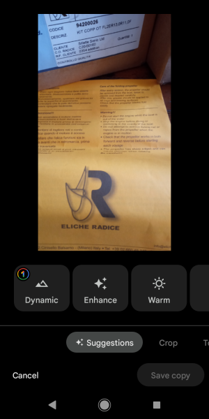

You should not need anything.
I've just bought a new ER folding prop and the instructions from the manufacturer state quite clearly to 'dismantle and grease yearly'. Our last ER folding prop lasted 23 years and we never dismantled it or greased it so I guess either works

I think for the first year we'll go with manufacturers advice. If there is no grease left at the next lift out then I guess it's a bit of a pointless exercise.
