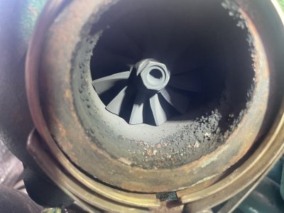

Took the boat out for the first time (2nd owner, 268 Albemarle) and have an issue with the KAMD300 not revving above 2250 rpm. The blower was cutting in but no turbo. After 2250 rpm if i pushed the throttle further forward i just got an increase of black smoke.
Recently done all filters, fluids and and topped up with new fuel.
Engine seems to running beautifully up to 2250 rpm.

Check the flap in the plastic Y induction piece isnt stuck
Check for boost leaks in all the pipe work. S/c should cut out around 2600 I think so looks like you’re losing air somewhere
Is the bottom clean and are the props clean
When was it last running well and what’s changed or been done between now and then
