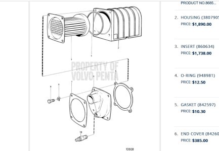

Thanks "oldgit" I have tried to find a schematic showing the path of the water from the sea into the engine and back out again but have failed.Will keep looking.Thanjs again Stephen
used to be several exploded parts diagrams online from parts VP dealers showing the pipes going from water filter to raw water pump and then to oil cooler.
Seem to recall on all my rather ancient engines it was a rigid copper pipe sealed at the joints by "O" rings and real PIA to make everything watertight after any disturbance .
