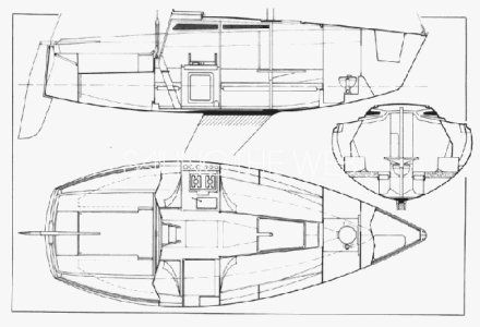

I thought initially it would be tender but the tumblehome would stiffen her up?
I think it's not tumblehome per se that stiffens, but the beam (in conjunction with the hull shape). Tumblehome is just beam that isn't carried all the way up to the deck. It's usually pretty, but requires a little extra care berthing.
Jouet 24 looks a generally nice boat, if perhaps a little sporty for what I imagine to be your intended purposes.
Expansive side decks for Mrs. W! (Note they're outward sloping - less reassuring when you're on the level, but when you're heeling easier than level ones on windward side, albeit at the cost of even more challenging than 'normal' on the leeward side.)

It's stern is different to the drawing in your first post and other Jouet 24s I've found pics of. It looks like very professionally done if it's had a rear extension, or perhaps it's a different model?
