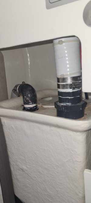

Are you sure the pipe from the pan outlet goes to the bottom of the black water tank? That doesn't make sense, you'd be pushing contents upwards against the weight of stuff already in the tank, solids settle at the bottom that could block that narrow pipe etc.
In your pic, is the syphon mounted a little low? I thought it should be above the top level of the tank.
There are only 2 hoses at the top of the tank - see photo below - one is the deck pump out and the second is the vent. I can't get a photo of the hose going into the bottom of the tank because it goes through the shelf the tank sits on. As I said earlier I believe the toilet discharge hose is connected to an internal pipe inside the tank which takes the waste to the top for discharge into the tank. There's a name for this pipe but it escapes me. The internal pipe keeps the pressure of the contents off the hose.
My understanding is the anti syphon has nothing got to do with the tank. It's on the sea water intake side and needs to be above the level of the toilet, which it is.20241018_144144.jpg
Sorry, but I really don't understand this. I've never encountered a system with valves on the discharge hose between the toilet and the tank.
