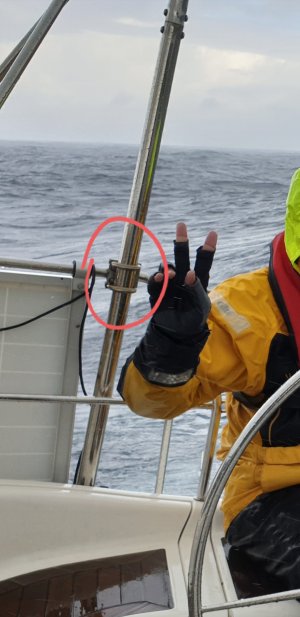

Shame I don't have a clearer photo but are you looking for something like I have on the wind generator pole fastening it to the pulpit..?
It's basically a flat square of metal about 75mm x 75mm with two 25 mm u-bolts through it vertically and two 50mm u-bolts through it horizontally on the other side..
(So just 8 small holes to drill in the square plate if you make it yourself, although I do recall a chandlery somewhere selling them in the past).
I was trying to describe what is easier seen in the picture below - Wish I could recall which chandlery sold them ready made up..
Once the u-bolt heads are ground flat with the nuts, you don't notice they're there.
TBH - I think I made mine from a spare keel stud washer about ten years ago. I intended at the time to replace with a stainless plate but it's worked fine ever since.

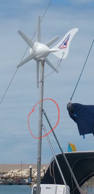

Ahhhhh. So it's the bracing that you need rather than the connection to the pulpit..
The upper part of the my 50mm wind generator pole is braced with 25mm braces, but that type of connection would not prevent a dinghy turning the davit.

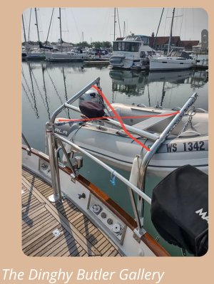

How about putting a cross brace like I added in red to the photo (from the internet) below..
The triangulation would prevent side to side movement of the ends..

I thought about that, and it would stop the rotation, but it doesn't solve the issue of connecting 25mm to 50mm.
It would also get in the way climbing up the transom ladder.
