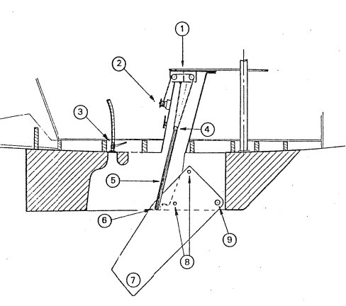

found this pic on google search, looks the same as on my sundream
(i replaced the rope and carpet on mine)=
also when i got the boat 4 years ago i had the original yard in burnham remove the lifting keel, check the mechanism, pivot pin and shotblast and epoxy seal the keel
diagram of the mechanism=
1: Pulley Box
2: Raising winch and cleat
3: Drop keel release valve with hose tail (access under floor)
4: Drop keel arm pulley
5: Drop keel arm
6: Drop keel arm axle
7: Drop keel
8: Lateral centring studs
9: Drop keel axle
Jeanneau Drop Keels - Jeanneau Owners Network
Im unable to get at the lift keel at my club however but am thinking of going to another local club this year or next to get the boat high enough to check it all again.
