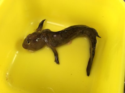

Failure to get water to come in may, as mentioned above, be a small crab or bit of debris on one of the upper valves. Take the six screws out of the top cover, remove it and have a look.
