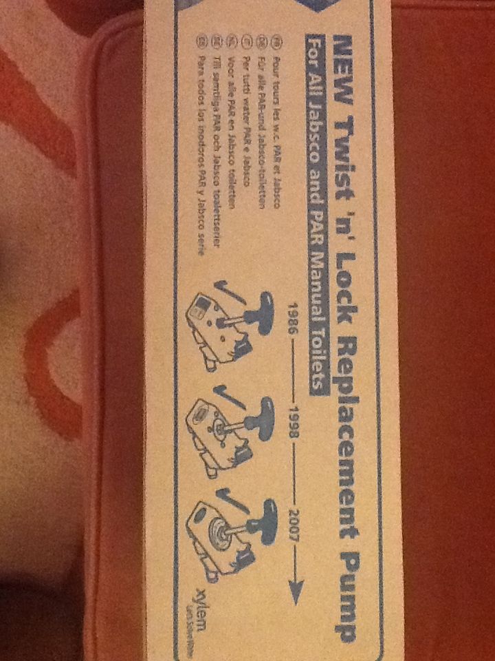

It is only necessary to replace the top unit of the pump, leaving the barrel and the rest in place. I bought this lot at our chandlers last year and also installed a syphon break. It's not a particularly dirty job since sea-water has cleansing properties. Anyway, it's the skipper's responsibility to do the dirty tasks.
