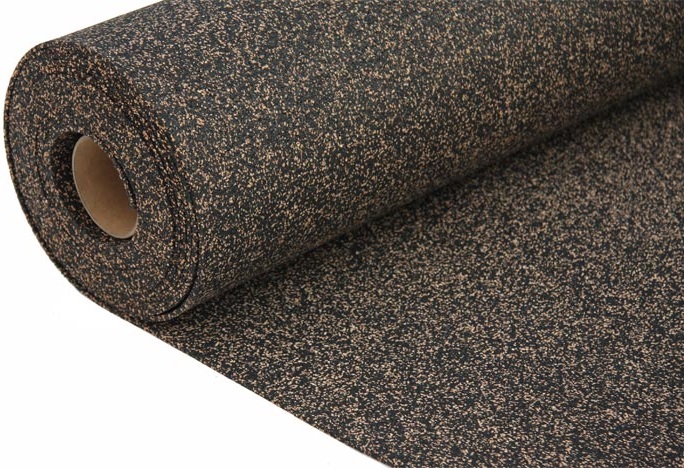

They do it with rubber infilled as well. This would be the perfect surface to use for a boat but would look pretty crap i would think. Its great for DIY gaskets though.
