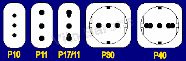

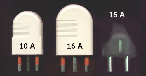

In the two pics below, the sockets corresponding to the 10A and the 16A plugs (mind, only the white ones, I'll come to the black 16A plug later) are those marked as P10 and P11 respectively.
But over time, it became obvious the convenience of a 16A socket capable to accept also 10A plugs.
The result was the P17/11 socket (called "multipasso" in IT), that can accept both the 10A and the 16A plugs.
From what I can see in your pic, this is the type of sockets Itama installed.
And as far as IT standards are concerned, this is the end of the story.
But after Shuko became EU standard (hence having many appliances sold, also in IT, with the Shuko plug), the plot thickened.
In fact, Shuko plug (the black 16A in previous pic, with its corresponding P30 socket) has the same pins distance as the IT 10A, but their diameter is a bit larger - the same of the IT 16A.
Therefore, while at first sight you might think that a 16A Shuko plug can fit a P10 IT socket, it actually can't, because of the larger pins diameter.
Which is logical anyway, because not only you don't want to connect something that can draw up to 16 amps to a line+socket sized for 10, but even if you could, the GND would still have no connection.
Actually, you can force shuko plugs into some "softly built" P10 or P11/17 sockets, if you push them hard and you don't mind risking to break them.
But what you can get is a non-grounded connection at best, and an electric shock at worst... :ambivalence:
Then again, the need for handling different stuff with the same socket (as the P17/11 socket in your Itama could do with both the 10A and 16A IT plugs) became even higher after the Shuko introduction.
This brought to the P40 socket in above pic, which can accept:
- Shuko plugs, because the pin diameter is sized accordingly and it grants a proper GND connection (through the side contacts);
- 10A IT plugs, even if the pins are a bit smaller than their corresponding holes, again with a proper GND connection (through the center pin). The only drawback with 10A plugs used in P40 sockets is that mechanically the connection is a bit loose. Just for the records, the IT 10A plug can also fit the P30 Shuko socket - at least the one as in the above pic, with the center GND connection. In fact, original German Shuko sockets were designed to take only Shuko plugs, and didn't have the center hole replicating the side GND contacts.
- 16A IT plug, similarly to what was already allowed by P17/11 sockets.
Of course, before replacing old P10 sockets with any newer "multi" socket, it's important to check that the line behind it is sized to handle 16A, for very obvious reasons.
And also when using adaptors, a bit of common sense is required. But this is true regardless of plugs/sockets standards - same as when using multiple plugs extensions... :)
