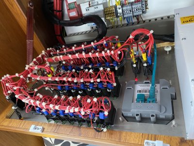

It is the RCD. I will investigate the connection on the switch panel which is both scary and rather beautiful at the same time.
I will not be back on board for a while though.
