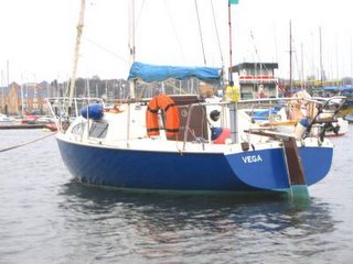

... why I shouldnt' use PVA to seal my rudder?
The rudder has been stripped back to the wood and I've decided that it looks better that way. However, it still needs to be sealed and I thought a PVA solution may be a cheap ane effective solution.
