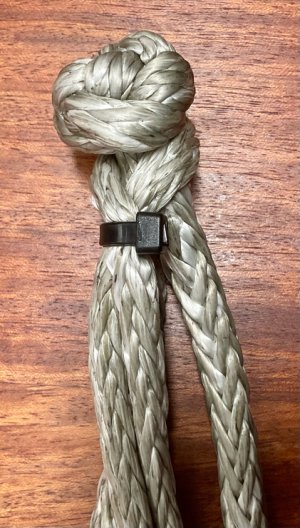

Soft shackles are very secure without mousing so the cable tie trick is rarely needed, but it can be useful on a semi permanent connection. We have only one "moused" soft shackle on board at the moment connecting the bitter end of our rode to the boat.
You can also "mouse" a soft shackle simply to make it more difficult to undo. This can be useful if you have young inquisitive kids on board or to slow down opportunistic thieves from quickly undoing items on the dinghy such as the stern anchor.
