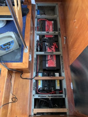

Reading this with interest, I have a Victron 24/2000/50 Multiplus Compact with two semi traction 230Ah 12V batteries in series for the 24V domestic, the lower 12V battery is at a lower state of charge compared with the other 12V battery, just now and for most of today I have been charging the lower battery to get it to a point where I can connect the battery balancer I got this week.
