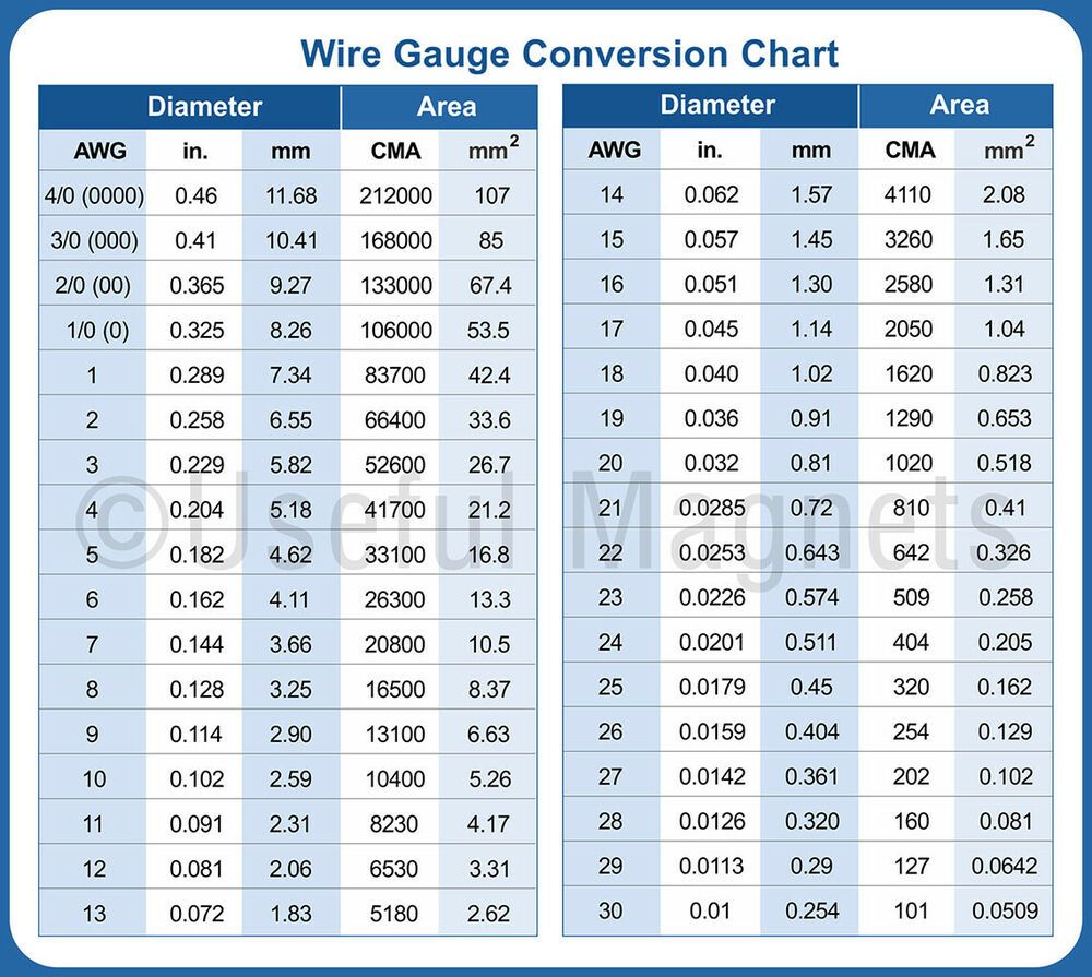

The first chart is a great set of examples of what was mentioned in posts #15 and #16. As one example, top row, 250/300a needs 1/0 cable as a minimum, to carry the current. Yet the chart allows for as low as 4ga, which is only rated around 140a
You were right to question the manufacturer, those cheap end inverters come with stupid sized cables.
Nothing wring with crimping the terminal on, as long as you used a decent hydraulic crimper.
I had another look at the chart and I can see what you and Vic are getting at. AND I'll beef up the input leads to the inverter(y)
