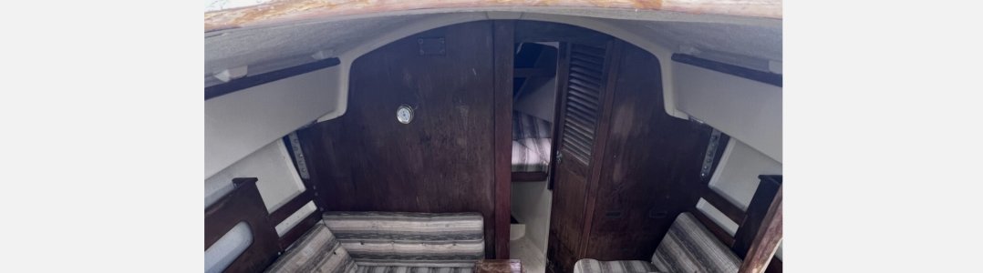

Right folks, Ive rashly bought another doer upper. Boat seems solid enough but the internal woodwork is badly neglected. I believe the majority of it will be a simple affair of lightly sanding down and then treating appropriately- a long tedious job but I’m up for that. However the main saloon bulkhead is incredibly dark, I’m unsure what the underlying wood is but I’m guessing it’s a fairly light teak veneered covering?
I suppose I should point out the boat in question is a Sadler 29.
So any advice on what I’m looking at here and thoughts on the best method to strip back and destain this horribly dark bulkhead would be welcome. I can’t find any YouTube links so if anyone has a link that too would be welcome.

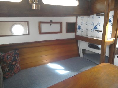

Different style of boat in the photo but shows what can be achieved with the combination of white and varnished hardwood trim. Probably a good idea to break up the expanse of white with some pictures

Hadn’t thought of doing that Tranona, could be a good idea especially if the surrounding wooden trim bits are solid teak and can be sanded back quite harshly - would make a pleasant contrast.

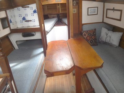

My boat is made of teak (above the waterline) but the internal surfaces are painted to enhance the light in the saloon, see attached. That bulkhead is a large reflective surface which would be better painted in a light colour to enhance the luminosity in the saloon.Saloon with rug.jpg

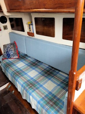

I have done that in the past. Same boat, different angle and the coachroof sides and top part of the bulkhead are recovered using Sapele faced 3mm door skins. They were originally very dark, almost black veneer which looked no better when stripped. The white below and varnished veneer scheme worked well on that boat and have used the same on my current boat. The white paint is Dulux Satinwood on special primer. The photos were taken about 20 years after the work was done. No deterioration in the paint or the Ronseal varnish!
