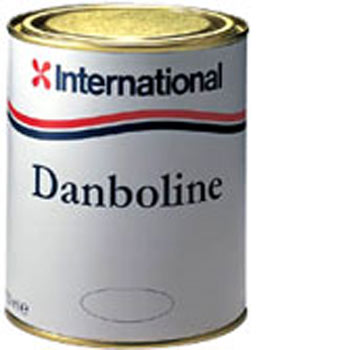

I used a a mixture of grey (on the hull) and white (on the coachroof) inside my Hunter 490 and it looks great. "Covers anything and sticks like shït to a blanket" (direct quote from the redoubtable Jane of Largs Chandlery).

Ian, thanks, I'm glad you found this thread - I'm pretty much doing the same as you and Duckling... I have a local source of Danboline too.

Good for me too, same plan and use Largs chandlery. An add-on question for you though; with a product such as Danboline, can you then stick things to it? Or would it need to be sanded away in areas to be glued to? Basically I may end up sticking insulation and/or carpet in areas eventually. Sorry if this is a hijack, Little Rascal.
If Jane says its "ok " then it must be!

mrjemm: Not at all - I'm thinking the same thing...
I'm painting over old paint and the remains of foam (I have done my best to remove it but some smears remain!)... It's just a tidy up at the moment but with the idea of insulating next year...
I wouldn't have thought there would be any problem sticking carpet to it. I would and will grind back to the grp before glassing bunks and the like in.
