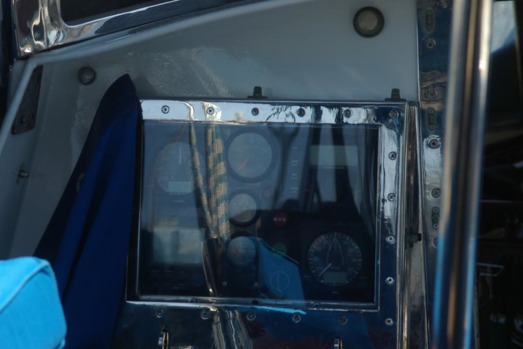

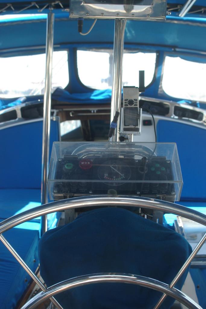

I have a Polycarbonate cover over both my cockpit bulkhead instrument cover and ny steering station instrument/switch such both have slide off hinges for easy removal.
