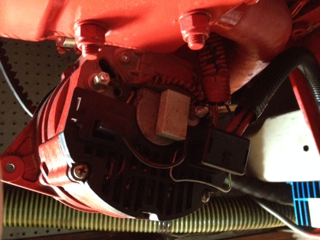

I've read the manual, and it all seems pretty straightforward. I now need to remove the bit from the back of the alternator in order to solder a couple of wires on there.
However, this is what I'm faced with:
It looks a little more complex than the manual would suggest, so I request some advice from the forum before I start indiscriminately removing bits from the alternator. Unfortunately, I also have no idea what brand it is. The label seems to have been painted over, so if anyone could let me know what the alternator is, that would also be handy.

It looks like an Iskra alternator.
Edit: Iskra products are now marketed under the Letrika name.
It is an Iskra alternator as also fitted to my Beta 30. I also have a sterling regulator ( that I've had for a year now)to fit and am loath to take the Iskra apart so I will be very interested to see how you get on.

Really you need to get in deeper to expose the brushes.
I guess for starters the rectangular black thing ( bottom of Tradewinds improved picture) with the two heavy red wire will unplug.
Unplug it and disconnect any other wires.
Remove the alternator.
Remove the large black cover and you should then be able to identify the brushes.
If in anydoubt take the alternator to an automobile electrician and get him to just solder on the wire you will actually need to use

Poecheng gets the gold star today. He's PM'd me instructions for my specific alternator. To say it's an easy job is an understatement. The brushes are on the component that's on the right of Tradewinds's retouched image. Two funny screws and it pops out. Solder away, job done. There's even a nice gap to lead the wire out.
