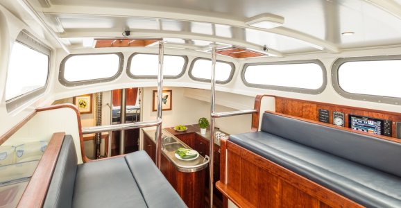

To my mind a deckhouse with good visibility is worth considering ……… providing that it doesn’t compromise the other aspects of the boat and sailing experience too much.
There are some (generally expensive) boats that combine a wheelhouse with a good sailing hull, keel and rig - Sirius for example.
