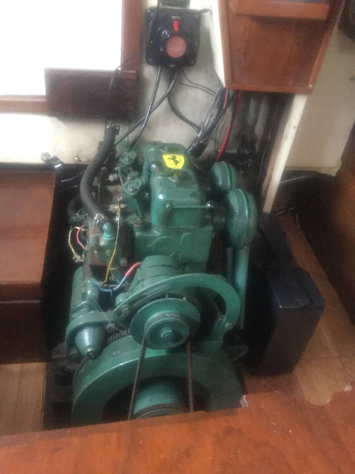

Volvo? circa? output? Thanks.
Looks like my MD2B from 1973 except that on mine the belt goes to the flywheel. Power was supposed to be 25hp.
I forgot that mine also has a starting handle.
Age is not significant; it is how it has been cared for that matters. Properly treated these engines can go on for ever
As I wrote earlier, mine dates from 1973 and is still going strong. The previous owner mainly used it for leaving and entering harbours; in my case it takes me around 20 minutes to go from the pontoon to open water. He also had a whole lot of spares that came with the boat. Spares can be a problem and, if you do find what you need, chances are that they will cost an arm and a leg. Some replacements can be made if you have the facilities. When the original exhaust elbow split, the genuine casting would have cost me a small fortune, IIRC around STG700. I fabricated a replacement out of stainless steel; less than €50 for the material. Some parts are simply unobtainable. When I had an old MD6a (or 7a?) on the Centaur that I had at the time and some valves were unobtainable I replaced it with a modern Lombardini with fresh water cooling.
Today I would go for an engine that is based on the Kubota, something like Nanni, Beta or one of the many others. The reason is that there are Kubotas all over the world being used for non-marine duty and spares are interchangeable, readily available and tend to not have the 'marine' price tag. Another factor to consider might be the weight of the replacement and its effect on the boat's trim; old Volvos tend to be heavy beasts!
Just my thoughts, of course. ;)
