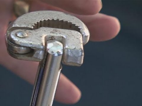

A plumber's basin tap wrench might be a neat way of coming at it end-on, but perhaps not something the typical home mechanic would have to hand:
Otherwise, how about one of those strap wrenches that goes on the end of a socket set instead of having its own handle? Maybe with a special shorter (or shortened) strap for this job?
Pete
Ah... that last one looks interesting. I'm sure that would work. The tap wrench won't work - no room for turning it. Now all i've got to do is find one out here in brittany;-) Wonder if i can make something similar for a 'one off' use......
