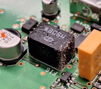

I have (3) MXA-5000 units and all three have failed - producing the same data output on both RS-422 and RS-232 like you are observing. This ICOM AIS receiver design is time-bombed.
The problem appears to be that of failed ceramic IF filters in the RF receiver frontends (1 each for AIS channel A & B). This is a problem that plagued certain amateur radio models - and is a result of a design mistake (lack of DC blocking capacitor) which leads to a constant DC current through the ceramic causing salt crystal growth.
This is a photograph of the first MXA-5000 I opened. No photo trickery. These were operated in a laboratory environment under controlled conditions.
It is a ~ $2 part if you can source it (M50EW) but without adding blocking capacitors in the repair - the problem will return.
Good analysis in the ham radio community:
The Mysterious Case of the Withering Filters
