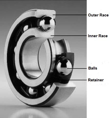

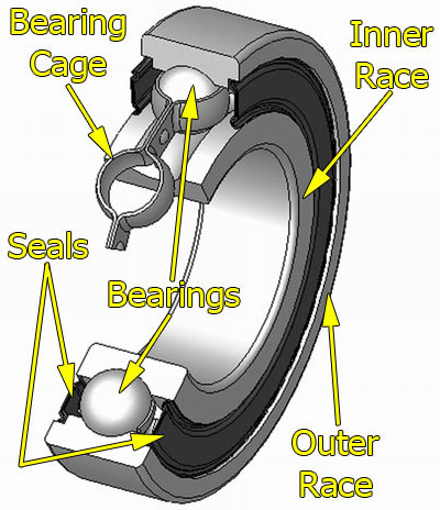

Hate to be pedantic but when you said it had two ball bearings I was confused.
