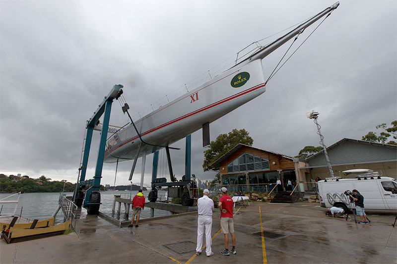

The underneath of Wild Oats XI - count 'em: bow centerboard, twin daggerboards amidships, canting keel and spade rudder (!). That's 5. What have I missed?
You've missed one - she also has DSS.
Thats another rudder at the bow, not a centre board.
The retractable bow centreboard is still there from last year, as are the twin daggerboards angling out on either side just ahead of the mast, and the tiny winglets on the giant bulb hanging from her slender canting keel.
But now, just behind the daggerboards is a horizontal foil, which when extended, sticks out about 2 metres from the side just below the waterline.
Like the other small foils, the stabiliser is retractable, sitting in a sheath across the interior of the hull. It is only when Wild Oats XI gets above 20 knots downwind that the stabiliser will be put into play on one side or the other, depending whether she is on port or starboard gybe.
Where is the DSS - has that been added since the photo or does it stick out of the hole above the daggerboards?
Ooh, like a sailing yacht's equivalent of a bow thruster?
Mike.
It is actually a centreboard I think - see above.

I think Wild Oats is something of a test bed for the system in bigger boats, as they're only talking about using it a high speeds downwind, whereas the boats designed for it are using it in anything except light winds.

Could be fascinating for use in Ocean cruisers. Although there may be a problem with growth in the "trunk".
As you say it's tricky to determine. Some pages report it as a rudder, others a centreboard.

Is the port DSS deployed in the photo?
