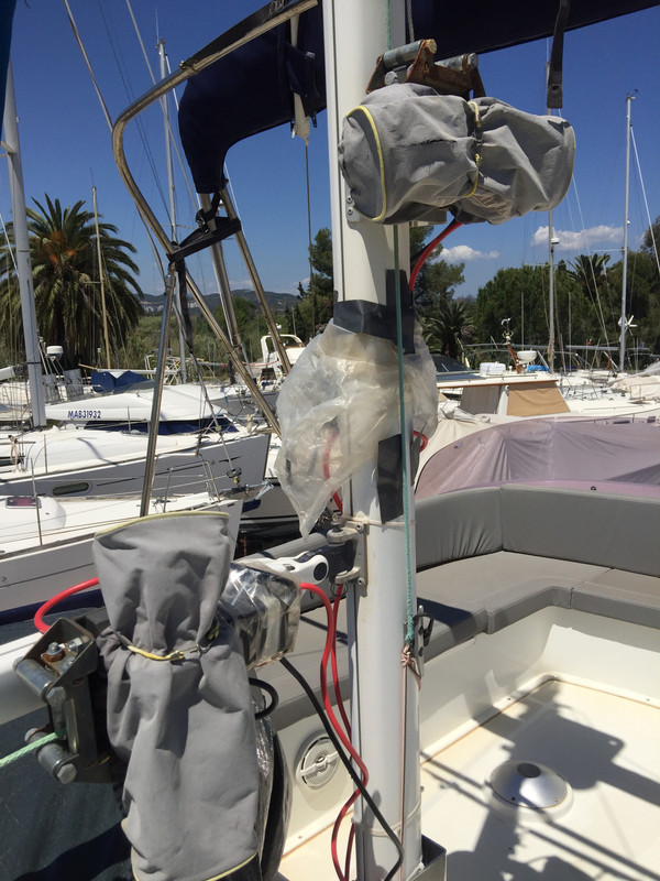

Anyhow this is not to say that this is what you must do, it’s just to show that the wiring is very simple. These photos are crap, the sun’s glare today was incredible and there was a cloud of dust from the bloke next to me grinding his hull, i couldn’t see a thing.
But here is the big WARNING and disclaimer. Do not try this at home at school or anywhere. A winch is NOT a hoist, it is most definitely not made for lifting. But if anyone was stupid enough to follow my advice, remember, that not all winches are the same, you must get one with a mechanical braking system, that means you cannot use the ridiculously cheap ones. Second, only estimate the lifting capacity as a tiny fraction of the pulling capacity (I’ve used 10%). But those tiny quad bike winches are remarkably powerful. What’s more your mast only has a capacity of 120 kg, and your dingy and outboard is way less than that (as long as it’s not full of rainwater).
And always remember with any lifting keep bodies and body parts out of the way. Phew....

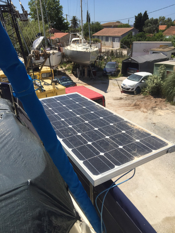

I’ve used the existing mounts from the self tailing winches but I think I probably moved them slightly so the winches don’t come in contact with each other when raising the boom

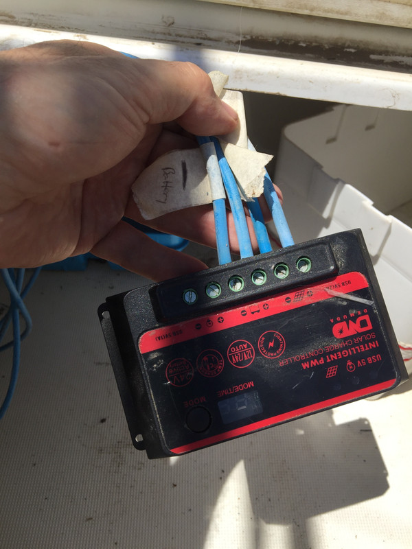

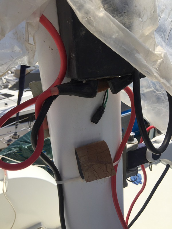

It is just two wires, positive and negative, from the winches to the winch controllers
The solar panel can be raised or lowered to either track the sun or keep it out of the way of your launch
The forum is working at a painfully slow speed today
And a pos and neg from the panel to its controller and then pos neg back to the battery
And hey presto that’s it
And these are the remotes

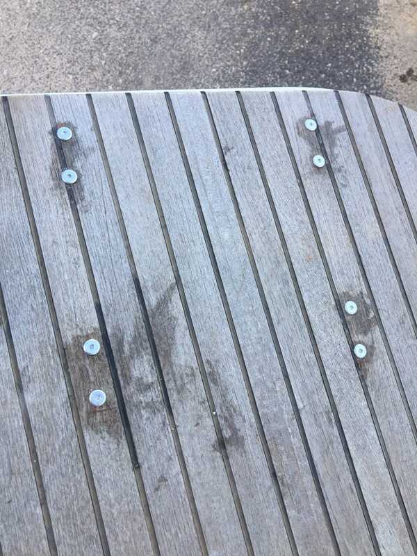

Moving the swim ladder you say!! This is what I did this evening
Well I removed the old swim ladder (too big, always in the way) and put a discreet one in its place (but on the port side).
I used these to attach it, because they probably won’t stub your toes
I used eight because that is how many fixing holes there were on the ladder
The studs were long to clear the lip of the swim platform
And look! Four rungs!
Going to have to wait for the warm water to test it and see if it needs a hand hold or something.
