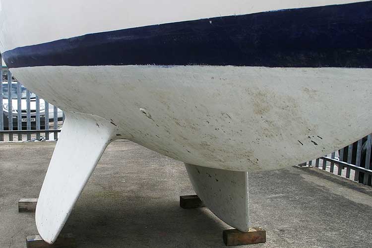

I thought the keel on a Hurley 24/70 was part of the moulding and didn't have keel bolts.
This bilge-keel version seems to be bolted on:
I can't see anything that looks like the cut-off stub of a moulded-in fin keel, so if there was a fin version then presumably that was bolted on too.

The owners web site gives us the Info There are No actual "keel bolts" but fin and bilge keel are encapsulated in mouldings which are then bolted onto the same hull mould.
"Interestingly there was only one mould for the 24/70. The keel combination was made up by bolting modular keel moulds into place which provides the moulded bulb keel shape that is so useful without the need for keel bolts that provide so much trouble for owners of other makes."
