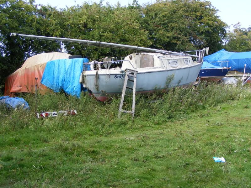

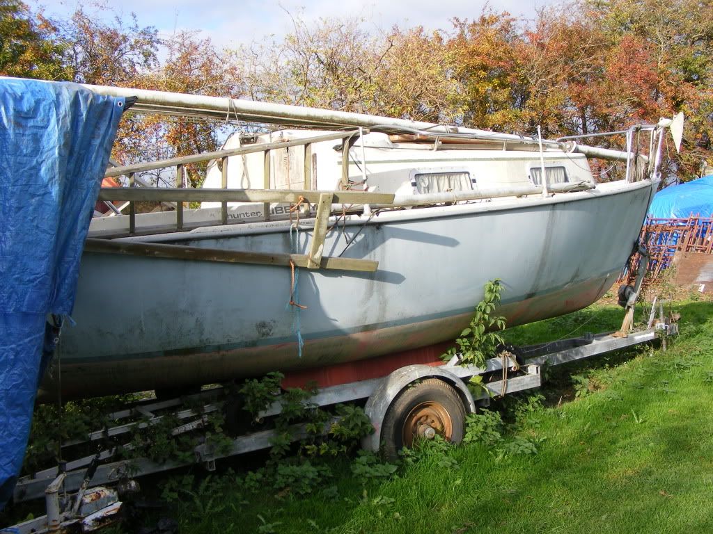

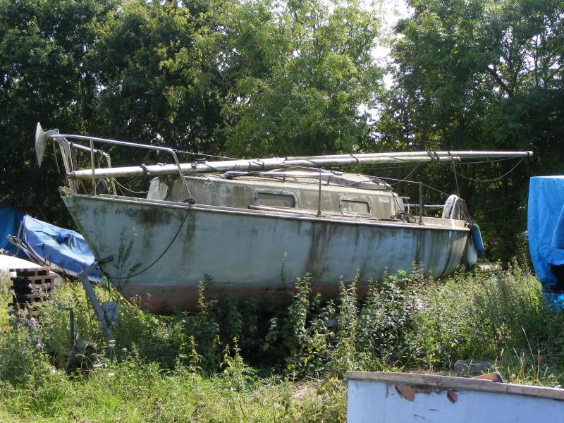

This one in the yard is on a 2 wheel trailer.
I asked about it when Dylan expressed an interest before but the yard traced the owner. She said she had forgotten about it, said she wanted to keep it and paid several years worth of outstanding debts!
Displacement is only a little more than 1 tonne so a two wheel trailer is feasible but the limit for two wheeled trailers is probably around 1800kg gross weight. It 'll not be towable by a small hatchback though.
